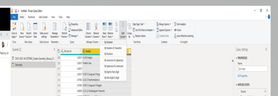

Hey all - Background: I work in K-12 Ed and am diving into Power Bi. I am working on a project that essentially will create a dashboard for every unit in a course all in one file.
My problem continues to be the fact that my data source is an exported gradedbook in CSV/Excel. My biggest problem in that is the fact that the LMS includes all units/sections a student is enrolled in, in one field. So several records look like this in my data source: (keep in mind there are many other fields, such as test, quiz, notes, etc.)
Studnet Name      Student ID        Section
Student A             9999999            Unit 1 and Unit 2
Student B             1999999            Unit 1, Unit 2, Unit 3
Student C             2999999            Unit 4
What I want it to look like is this so I can isolate the Section, then easily apply filters, slicers, etc. based on Unit...
Student A             9999999            Unit 2
Student B             1999999            Unit 2
Student B             1999999            Unit 3
I would eliminate the Student Name field at this point and create a different table with Name and ID and have a seperate table with ID and Section. Problem is I dont know:
1) Should I do this before I connect the data source to Power Bi or can I do it while transforming the data in Power Bi? AND
2) The syntax/methods to use. I assume it would be some variant of concatenate from Excel with the ability to read the whole string/array and break it up, but it has to bring/duplicate ID with it too.
Here is a screenshot of data with names and Ids changed. Ids are unique and the key
Any help, ideas, or holes to go down appreciated.
