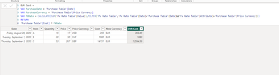

Hi, @NordicS3130
Based on your information, I create sample tables:
Then create a calculated column and try the following DAX expression:
EUR Cost =
VAR PurchaseDate = 'Purchase Table'[Date]
VAR PurchaseCurrency = 'Purchase Table'[Price Currency]
VAR FXRate =
    SWITCH(
        PurchaseCurrency,
        "USD", LOOKUPVALUE('FX Rate Table'[USD], 'FX Rate Table'[Date], PurchaseDate),
        "GBP", LOOKUPVALUE('FX Rate Table'[GBP], 'FX Rate Table'[Date], PurchaseDate),
        "CHF", LOOKUPVALUE('FX Rate Table'[CHF], 'FX Rate Table'[Date], PurchaseDate),
        "CNY", LOOKUPVALUE('FX Rate Table'[CNY], 'FX Rate Table'[Date], PurchaseDate),
        "INR", LOOKUPVALUE('FX Rate Table'[INR], 'FX Rate Table'[Date], PurchaseDate),
        "NOK", LOOKUPVALUE('FX Rate Table'[NOK], 'FX Rate Table'[Date], PurchaseDate),
        "SEK", LOOKUPVALUE('FX Rate Table'[SEK], 'FX Rate Table'[Date], PurchaseDate),
        "DKK", LOOKUPVALUE('FX Rate Table'[DKK], 'FX Rate Table'[Date], PurchaseDate),
        "JPY", LOOKUPVALUE('FX Rate Table'[JPY], 'FX Rate Table'[Date], PurchaseDate),
        "KRW", LOOKUPVALUE('FX Rate Table'[KRW], 'FX Rate Table'[Date], PurchaseDate),
        "THB", LOOKUPVALUE('FX Rate Table'[THB], 'FX Rate Table'[Date], PurchaseDate),
        BLANK()
'Purchase Table'[Cost] * FXRate
Here is my preview
