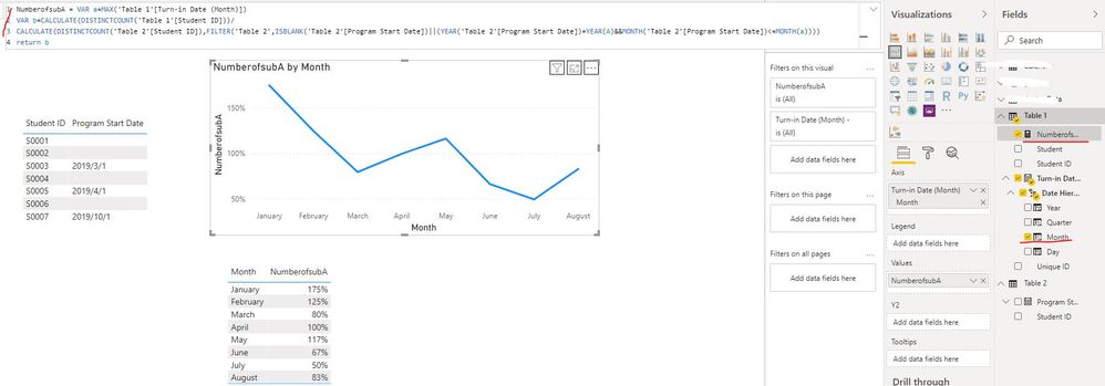

    If I understand correctly , you have two tables : Table 1 and Table 2 . Table 1 contains the student ID and the date which the student submit assignment , and Table 2 contains the student and the date the program was started . It looks like as below:
    Your expected result is to get one line chart as below screenshot with data in X axis and the percentage of active students number and the submitted assignments display in "Values" field?
    Whether the above understanding is correct? If no, please correct me. And could you please provide some sample data (exclude sensitive data) from this 2 tables with text?

      As for the line chart, you are absolutely correct. I would like to display each month in the x-axis and in the "Values" field I would like to have the average of submissions per active students on a monthly basis.
      For example, in January, I would like to display the value: (7 Submissions)/(4 Active Students) = 1.75 or 175%
      So a value for each month on one continuous line graph.

        Hi cmaloyb ,
        You can create one measure as below:
        NumberofsubA = VAR a=MAX('Table 1'[Turn-in Date (Month)])
        VAR b=CALCULATE(DISTINCTCOUNT('Table 1'[Student ID]))/
        CALCULATE(DISTINCTCOUNT('Table 2'[Student ID]),FILTER('Table 2',ISBLANK('Table 2'[Program Start Date])||(YEAR('Table 2'[Program Start Date])=YEAR(A)&&MONTH('Table 2'[Program Start Date])<=MONTH(a))))
        return b
        Rena
