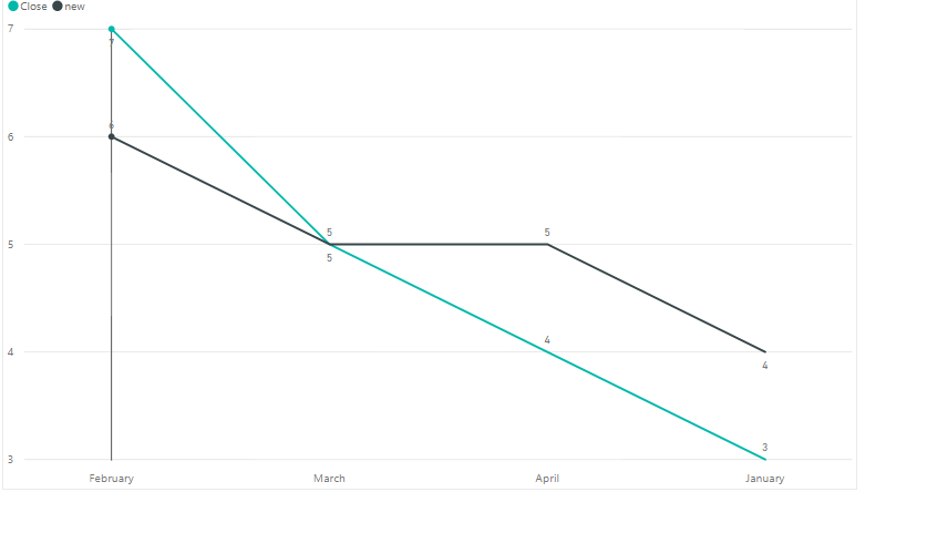

    Here I made a sample like this.
    In the sample I created two measures to achieve the goal.
    Close = CALCULATE(COUNT(Table1[Status]),FILTER(Table1,Table1[Status]="closed"))
    new = CALCULATE(COUNT(Table1[Status]),FILTER(Table1,Table1[Status]="new"))
    Here is the result for your reference.
    For more details, please check the pbix as attached. If it doesn’t meet your requirement, kindly share you sample data to me.
    https://www.dropbox.com/s/lba582729qiu74x/Line-Chart2.pbix?dl=0
    Frank
      Hi Frank
      Thanks for your solution. For me i think it is not the right one. Because with this measure it just count the actual status (new or closed).
      - I should have one that counts the created items per month (that could be status new, or closed. For example: in Jan we create a item and close it after a week. So your measure doesnt count this to new...).
      - The other line in the chart should show just the closed ones (i think for that is your measure good ;) )
      You can imagine it like a IT ticket system, you wanna know, how many tickets were opened last month....and how many closed...
      I hope I could explain it better ;)
