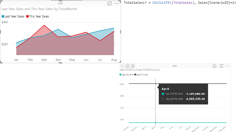

Dear Angelia,
I tried your code for 2010 and adjusted it to 2009, but I only get the following figure on the right. The figure on the left is how I want it to be and the code on the upper right side it the code they used. The pbix file is the sample of your retail analyses (from power bi site).
Hi @0xygen27,
Got it, I thought there only year on x axis. Please try the following steps.
1. Create another table only including data, name it as 'NewTable'. Create calculated column year=Year[NewTable[date]] .
2. Create the meaure using the foluma.
SalesYTD = CALCULATE ( Orders[Total sales], FILTER ( ALL ( 'Date' ), 'NewTable'[Year]=2010 && 'Date'[Dates] <= MAX ( 'Date'[Dates] ) ))
3. Create the visual and check if it works fine.
If this is not your case, could you please share a sample data. Maybe your data is private, you can create fake data.
