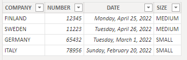

    Data table:
    Company table:
    Comment table:
    I think you can try this code to achieve your goal.
    Measure =
    VAR _List = CALCULATETABLE(VALUES('Table'[Size]),ALLSELECTED('Table'[Size]))
    IF(MAX(Company[SIZE]) IN _List,CALCULATE(SUM(Commnet[count_of_comment])+0))
    Result is as below.

    Data table:
    Company table:
    Comment table:
    Measure =
    Result is as below.

    Thanks a lot for your reply. Indeed, I noticed already earlier, that my issue must be related to table relations, because if I took values from one table only, this didn't happen.
    I modified your pbix a bit and added three example tables which describe more my real world case. The measure I created based on your suggestion was:
    commentCount2 =
    VAR _List = CALCULATETABLE(VALUES(Theiren_Orders[Size]), ALLSELECTED(Theiren_Orders[Size]))
    IF(MAX(Theiren_Orders[Size]) IN _List, CALCULATE(SUM(Theiren_Comments[count_of_comment]) + 0))
    And this did the trick (the only diff compared to yours was that I have the size information only available in the "Orders" table, but it worked like this anyway)! I would like to attach the modified pbix here to help others, but I can't see any attachment options.
