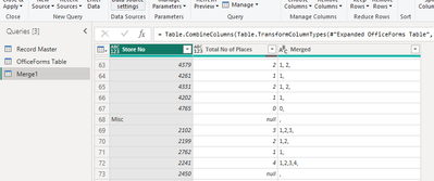

I have duplicate numbers from two columns merged together in Power Query. Can these duplicate numbers be removed from each cell?

Hi @Anonymous I have tried this and it fails when it goes past 9 so from 10 onwards it will remove as it thinks is a 1 and just will leave a 0, for say 11 it will remove as there is a 1 there. Any ideas on how to resolve?

Hi, no there is not, its 1, 10 for example

Hi @Shivu-2000 sorry for the delay I had to create a new report removing the senstive info.
Link here https://drive.google.com/file/d/1-2imAhCyfFxoR5xH5aSeBs7egEG8ZAbe/view?usp=sharing
Query -Merge 1 and the Merged Column is where the duplicate numbers need removing from each row

Why is the answer 3 in cell C6? Shouldn't the answer be 2,0,4,5?
2045 is the store number

@Shivu-2000 thanks for your time. Apologies Im even more confused. This is what I am trying to acheive.
Cell example = 1 2 3 4 5 1
Looking at the above there are 2 '1's - I need to remove the additional '1' so that its just '1 2 3 4 5'.
