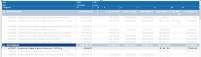

Hello everyone, I wanted to consult you how I can do to total my inventory regardless of the warehouse in which it is, since when the warehouse is the same I can do it without inconvenience.
Where the example for the 31/12 gives the correct number but for the day of 8/1 should give above 90000 since I should do 8664 + 81441 but as they are in different warehouses they are not adding.
Try different ways to make a measurement but none of them worked for me
Will you have any idea how to do it?

    Hi, Syndicate_Admin
    There may be a problem with the filter in your formula.
    Please change yor formula as below:
    Valuarioninventario =
        SUM ( PBI_V_Valuarioninventario[Cost Amount (Actual)] ),
        FILTER (
            ALL ( PBI_V_Valuarioninventario ),
            PBI_V_Valuarioninventari[FechaContabilizaction]
                <= MIN ( 'PBI_V_Valuarioninventari'[FechaContabilizaction] )
