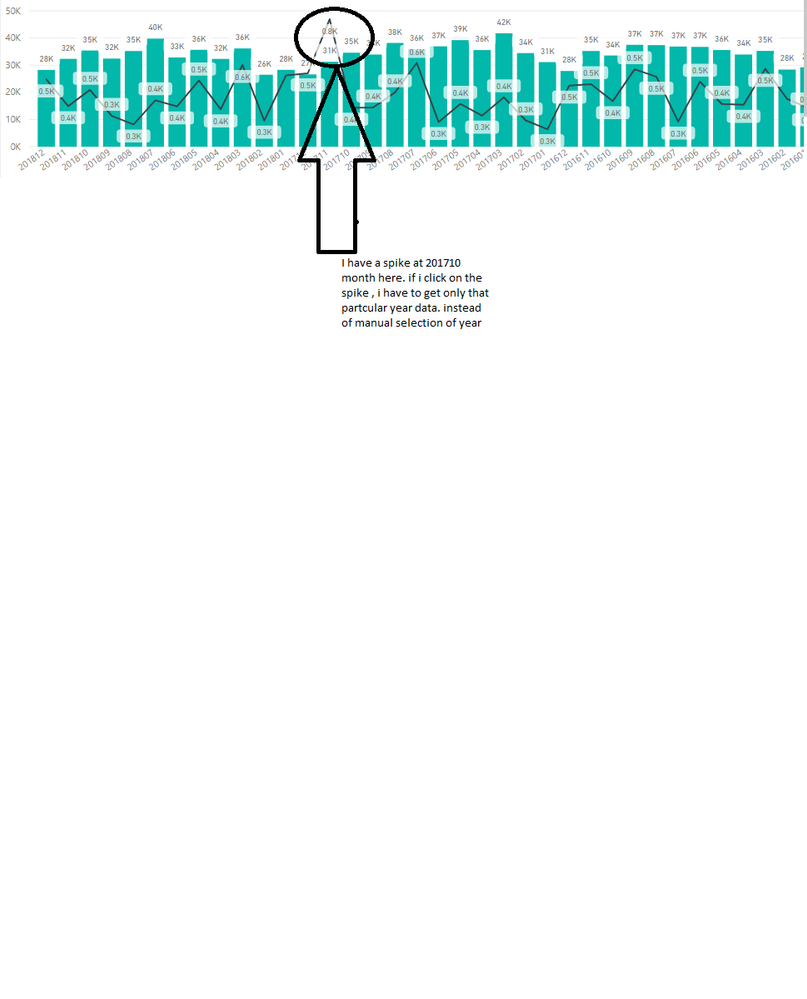

How to report year wise data if we have multiple years in line chart?
Hi Experts,
suppose i have 5 years data i have reported as trend wise. if i select on particular spike (High) . how can i report only the data for particular year?
suppose i have taken here line chart. one of the year reporting huge high i want to see the data for only particular year out of many back dated years?
Please suggest.
Rajendra

Hi
Pleases find the attached snapshot.
