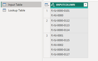

Below is the first input table with one column that contains the values that I want to lookup. Each cell contains multiple values as shown.

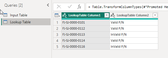

The lookup table below contains 2 columns, the first column matches the content of table 1 above. Column 2 is the value that I want to lookup.

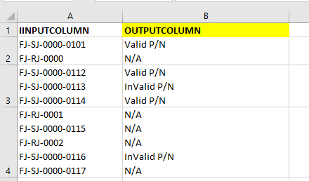

3. Desired Output
Below is the desired output where values of "LookupTable Column2" from the 2nd table get matched up to the "INPUTCOLUMN" from table 1. I want the output in this format since i want finally extract the output in an excel just the way displayed in the snapshot below.

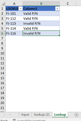

i don't know why the line change code does not work in powerbi. So I did this in excel
pls see the attachment below

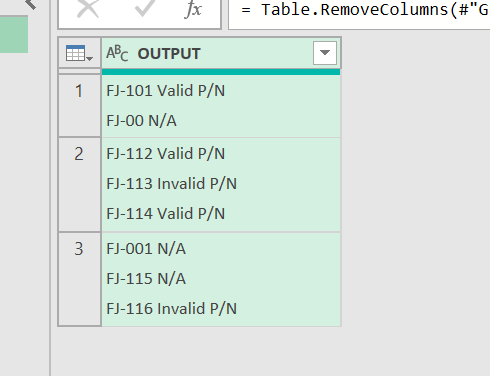

pls see the attachment.
The wrap does not work after you load the data. However, you can see it works in the power query.

Also, I forgot to mention one more thing is that in your last snapshot (output) i want the "Valid, invalid, N/A" in a separate column as shown in my Desired output snapshot in initial post.
