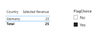

Hi @TusharGaurav
Create a table to use as your slicer (Modeling - New Table)
SlicerFlag = DATATABLE("FlagChoice", STRING, {{"Yes"}, {"No"}})
Then, add the following measure to your data table
Selected Revenue =
VAR SelectedFlag = SELECTEDVALUE(SlicerFlag[FlagChoice])
    SWITCH(
        SelectedFlag,
        "Yes", CALCULATE(SUM('Table'[Revenue]), 'Table'[Flag1] = "Yes"),
        "No", CALCULATE(SUM('Table'[Revenue]), 'Table'[Flag2] = "No"),
        BLANK()
Now add country and your 'selected revenue' measure to a table visual, and add the 'FlagChoice' column from your slicer table to a slicer visual
I hope this helps. Please give a thumbs up and mark as solved if it does, thanks!

Hi @TusharGaurav
Selected Revenue =
    SWITCH(
        SelectedFlag,
        BLANK()

@TusharGaurav Hey ,
I will follow below steps
Step 1 : Create a slicer table using below dax
BooleanParameter = DATATABLE( "Option", STRING, { { "Yes" }, { "No" } } )
steps 2: Drag Option to a slicer.
Step3 : Create a new measure using below dax
SelectedRevenue =
VAR SelectedOption = SELECTEDVALUE(BooleanParameter[Option])
SWITCH( TRUE(), SelectedOption = "Yes",
CALCULATE(SUM(YourTable[Revenue]), YourTable[Flag1] = "Yes"),
SelectedOption = "No",
CALCULATE(SUM(YourTable[Revenue]), YourTable[Flag2] = "No"),
BLANK() )
Step 4: drag the same measure in table viz and change slicer from slicer viz
