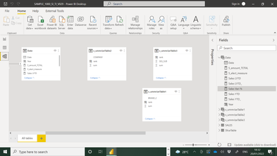

How to combine Table 1 and 2 into 1 table ?
Hi All
My  TAB BRAND ,Table 1 working fine :-
MY TAB COY , TABLE 2 WORKING FINE :-
Can some one share with me how to combine table 1 and table 2 into one table ?
My sample PBI :-
https://www.dropbox.com/s/neiaj147r3hft53/SAMPLE_1000_SI_TI_V026.pbix?dl=0

Hi @admin11 ,
Please check the link to your sample PBI. There is no file in it.
Are you trying to get the results of two tables combined and sorted by account. I think the best way is combine all the underlying data firstly, after that, get a rank for them.

Hi @admin11 ,
There are two ways to do it:-
1. Append table 1 into table 2 in the power query
2. Or you can create a new table with below code:-
Table = UNION(s_ummrizeTable1,s_ummrizeTable2)

@Samarth_18
Thank you for your sharing. appreciate very much.
In my actual application , it have total 5 s_ummarize_Table.
I thinking the issue may be cause by rank field need to link up. i try , but i still unable to figure out how to link .  As this is a sample PBI file.
Below expression may be have some issue . it should be auto switch Rabk , but seen like it does not work :-
S_amount_TOTAL =
SWITCH(
SELECTEDVALUE(SliceTable[Slice]),
"BRAND_C",IF(ISINSCOPE(s_ummrizetable1[rank]),
CALCULATE(
SUM('SALES'[sales])
,FILTER(ALLSELECTED('SALES'),[BRAND_C]=MAX('s_ummrizeTable1'[BRAND_C]))),
SUM('SALES'[sales])),
"COMPANY",IF(ISINSCOPE(s_ummrizetable2[rank]),
CALCULATE(
SUM('SALES'[sales])
,FILTER(ALLSELECTED('SALES'),[COMPANY]=MAX('s_ummrizeTable2'[COMPANY]))),
SUM('SALES'[sales])))
