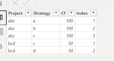

You can add an index column by project level using the linked method:
https://radacad.com/create-row-number-for-each-group-in-power-bi-using-power-queryand after you'll get the table like :
you can create a simple measure for summarizing only the first row of every project:
Cf_ = CALCULATE(sum('Table'[Cf]),'Table'[Index]=1)Result :
The pbix is attached

Hi Anonymous
If this post helps, then please consider Accepting it as the solution to help the other members find it more quickly

Thanks Rita - I tried it works on the aggregration level but if i use strategy as a filter. It doesn't know how to dynamically change the index (for example project abc should also be appreaing there) Is there a way we can dynamically make the index according to the strategy?
- Ritaf1983
Hi Anonymous
Update the formula to :Cf_ =if(HASONEFILTER('Table'[Strategy]),SUMX( SUMMARIZE('Table','Table'[Project],"Max strategy",max('Table'[Strategy]),"CF",sum('Table'[Cf])),[CF]),CALCULATE(sum('Table'[Cf]),'Table'[Index]=1))Results:
