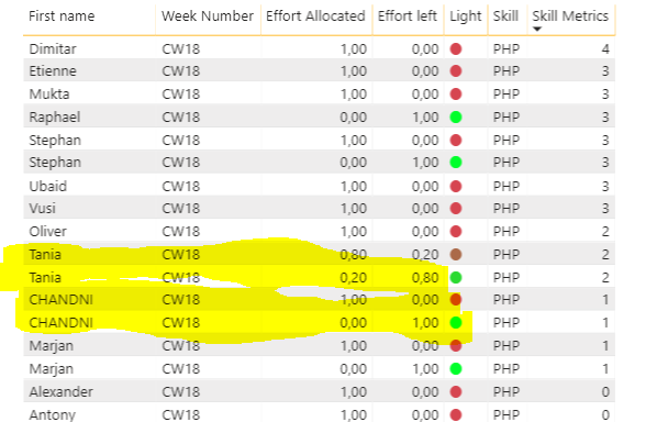

How to add two rows by a First name
I want to add up rows by First Name. So wherever there is a first name repeated I want to add them up so that the calculation of the rows give me an effort value of 1. For example I want to add the effort   by the first name Chandni which is repeated.

  • Hi Anonymous ,
    You may use ALLEXCEPT() so your formula should be something like:
    Measure =
    CALCULATE ( <aggregation>, ALLEXCEPT ( Table, Table[FirstName] ) )
    But Power BI automatically aggregages values whenever they are added to a visual. Power BI sums up, if applicable the values of a column. If you add First Name and Effort Located to a table, it will show you the total Effort Allocated for a each unique first name unless another column is added that increases an aggregation's granularity such as same first names but different last names.
      What formula should i use to write the same for a column. I will be using that for my traffic light system then

        Try this as a measure
            SUM ( 'Table'[Effort Allocated] ),
            ALLEXCEPT ( 'Table', 'Table'[First Name] )
        Replace Table with the actual table name.
