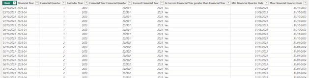

This request for help involves two tables (snippets of both are below):
dimDate
CustomerPurchases
The relationship between the two tables is dimDate[Date] 1-* CustomerPurchases[Purchase Date].
I'm expecting the output to show in the following fashion. Ignore the red error indications - I've renamed the DAX so to hide sensitive column names.
The slicer has the Financial Year and Financial Quarter (as an expanable node) from the dimDate table.
The table visual has the Financial Year and Financial Quarter from the dimDate table. The 'Customer IDs' contains the measure I'm trying to create. The DAX present is my latest effort (although I've tried various efforts).
I would like the measure to count all DISTINCT CustomerPurchases[Customer ID] records from the earliest CustomerPurchases[Purchase Date] up until the dimDate[Max Financial Quarter Date].
For example, looking at the dimDate table, for Financial Year 2023/24 and Financial Quarter 2, the dimDate[Max Financial Quarter Date] is the 2024/01/31. Therefore I would like the 'Customer IDs' measure to DISTINCTCOUNT all Customer IDs from the earliest CustomerPurchases[Purchase Date] to the (and including) 2024/01/31.
This same logic should apply to each Financial Year and Financial Quarter, regardless if the slicer is used or not. It's the row context that should be ascertaining the dimDate[Max Financial Quarter Date] to use as the max date in the measure.
I hope this makes sense.
How do I acheive this?
