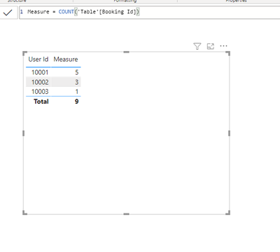

  • Hi Anonymous,
    Check details as below:
    Create a measure as below:
    Measure = COUNT('Table'[Booking Id])
    And you will see:
    For the related .pbix file,pls see attached.
    Kelly

  • PaulDBrown's avatar
    PaulDBrown
    Create a measure:
    bookings = COUNT ( Table [booking ID])
    and then create a visual using the field user id and the measure

      • v-kelly-msft's avatar
        v-kelly-msft
        Hi Anonymous,
        And you will see:
