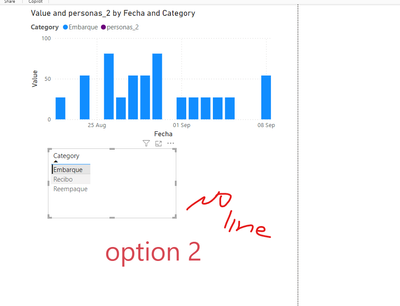

Hi @Fh3r1008
To achieve a wanted interaction you can apply these steps.
1. From PQ you need to unpivot the table :
2. Close and apply
3 There is 2 scenarios
3.1 if you want the line of personas to stay when you click on table like in the attached picture :
Create 2 measures :
1.
Sum_Exclude_personas = CALCULATE(SUM('Table'[Value]),FILTER('Table','Table'[Category]<>"Personas"))
2.
Value_personas = CALCULATE(sum('Table'[Value]),FILTER(ALL('Table'[Category]),'Table'[Category]="Personas"))
3. Create the graph, note that categories should be on the Legend
4 Create a table, and filter out the personas.
5. Format the interactions with the graph :
Result:
After table selection
If you want the line be hided too , apply all the same steps except of the measure for personas.
It should be :
Value_personas_2 = CALCULATE(sum('Table'[Value]),FILTER('Table','Table'[Category]="Personas"))
The result will be :
