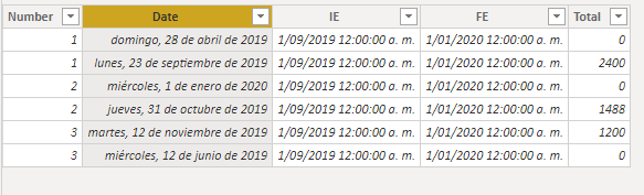

I have the following table call [Table]:
Where Number and Date are given
IE and FE are calculated columns and are given by the user.
IE = DATE(2019;09;01)
FE = DATE(2020;01;01)
And total is calculated column and is:
Total = IF(AND('Table'[Date]<'Table'[FE];'Table'[Date]>'Table'[IE]);DATEDIFF('Table'[Date];'Table'[FE];HOUR);0)
Then i create the following measure:
Medida = AVERAGE('Table'[Total])
Now, I add to the model the following table call [Dates]:
What I need is evaluate [Medida] with IE=FI and FE=FF, this means repeat the formula in the measure [Medida] changing the inputs IE and FE depending on which row of [Table] is and store the result in a new table or column.
My expected results if I store the result in a new column in [Table] (for the first rows are):
I already try a calculated column in table like this:
Columna = CALCULATE(FORMAT([Medida];"General Number");FILTER('Table';AND('Table'[IE]=Dates[FI];'Table'[FE]=Dates[FF])))
But it does not work because IE and FE in [Table] (First image in the post) are the same date in every row.
Do you have any idea?
Thanks.
I solved it with the following function:
Tabla = ADDCOLUMNS(SUMMARIZE(Dates;Dates[FF];Dates[FI]);"A1";AVERAGEX('Table';IF(AND('Table'[Date]>Dates[FI];'Table'[Date]<Dates[FF]);DATEDIFF('Table'[Date];Dates[FF];HOUR);0)))
It´s not the best way to do it but it was the only I can create consistent results.
