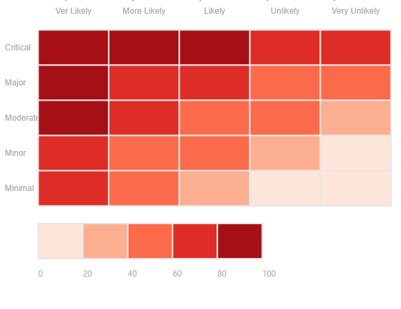

Hi
I need to be able to create a matrix like this which plots a value inside a matrix based on its score.
Could anyone offer some advice as to whether this would be possible and how it can be done?
Many Thanks
v-gizhi-msft
According to your description, i think i can not completely reach your requirement, but i have a workaround.
You can create a table called 'Heat Map' like this by Enter Data:
Copy this table called 'Heat Map (2)' in Query Editor and unpivot it, it shows:
Then choose Table Hearmap visual from App Source to show Table 'Heat Map', it shows:
Refer to your table posted, i create these measures to show each risk's X-axis and Y-axis in above heatmap visual:

Then try these two measures:
_Category =
SWITCH (
    TRUE,
    MAX ( 'Table'[Risk Title] ) = "Risk 1", CALCULATE (
        MAX ( 'Hear Map (2)'[Category] ),
        FILTER ( 'Hear Map (2)', [risk 1] = 1 )
    MAX ( 'Table'[Risk Title] ) = "Risk 2", CALCULATE (
        FILTER ( 'Hear Map (2)', [risk 2] = 1 )
    MAX ( 'Table'[Risk Title] ) = "Risk 3", CALCULATE (
        FILTER ( 'Hear Map (2)', [risk 3] = 1 )
    MAX ( 'Table'[Risk Title] ) = "Risk 4", CALCULATE (
        FILTER ( 'Hear Map (2)', [risk 4] = 1 )
_Attribute =
SWITCH (
    TRUE,
        MAX ( 'Hear Map (2)'[Attribute] ),
The result shows:
Here is my test pbix file:
pbix
Hope this helps.

Data.JPGThank you for replying
In this sample data, Risk 2 would be plotted in the upper right quadrant (as high risk) and risks 3 and 4 would be in the lower left quadrant
