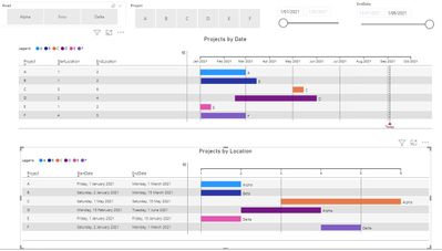

I have 3 roads where we have projects occuring. I want a visual that can be filtered by Date and by Road.
I want the information to show almost like a gantt chart or a bar graph, but primarily by location and secondarily by time.
Attached an example picture and the data. Not sure how to do this....Advice appreciated!

    The custom visual, Gannt chart by MAQ Software, will display your data as outlined, however filtering on the date also filters by location. This may help. See screenshot below.
    Gant Chart

    Hi DataUser ,
    Gant Chart
