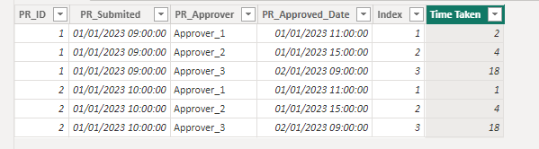

I first add an Index column with Power Query, then use below DAX to calculate the spent hours in a calculated column.
Time Taken =
IF (
    'Table'[Index] = 1,
    DATEDIFF ( 'Table'[PR_Submited], 'Table'[PR_Approved_Date], HOUR ),
    DATEDIFF (
            MAX ( 'Table'[PR_Approved_Date] ),
            ALLEXCEPT ( 'Table', 'Table'[PR_ID] ),
            'Table'[Index]
                = EARLIER ( 'Table'[Index] ) - 1
        HOUR

Thank you very much, it worked perfectly, I had to investigate how to create the index column but seeing the attached file was more than enough.
