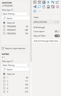

I am trying to divide Rating/Question (In this case, PRSQ5000) by the total count of 4006.
Manually I was been able to, but since I need to use an slicer the percentage need to update accordingly.
I tried converting the 84 to Show as Value: Percentage of Grand Total and the result I get is always 100%. Below picture for reference of the fields and applied filters:
I did the following (Sum of Rating of 1 and question: PRSQ5000 then divided by the grand total of 4009) but it did not work as expected even tho I got the expected percentage:
I would greatly apprecite if someone with knowledge could contact me for more details.

    (2)We can create two measures :
    Response = IF( HASONEVALUE('Sheet3'[RATING]), COUNT('Sheet3'[QUESTION|]) , FORMAT( DIVIDE( SUM('Sheet3'[RATING]) ,  COUNT('Sheet3'[RATING])),"0.00")  )
    % = DIVIDE([Response], CALCULATE( COUNT('Sheet3'[KPI_SURVEY_ID|]), ALLSELECTED('Sheet3'[RATING]) ))
    (3)Then we can put the measure and the filed we need in the Matrix visual and we will meet your need:
