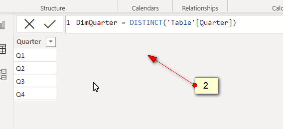

- Ahmedx
1) We need to create a column (Index)
2) also need to create two unrelated tables
3) need to correctly insert slicer and matrix columns
4) create measureBased on your description, I created data to reproduce your scenario. The pbix file is attached in the end.

Hi Ahmedx ,
Are those Year and Quarter slicers are taken from DimYear and DimQuarter tables ?
If it is taken from those disconnected tables , how can i get other KPIS to get filtered out since there are other KPIS on the page which gets filtered based on slicer selection.
- Ahmedx
alternatively, you can create a dotted link.
in some way it is not necessary to activate, but in others it will be necessary to tweak the function for this
USERELATIONSHIP
