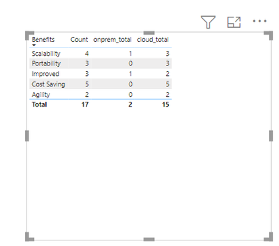

Your solution works perfectly fine 🙂
Thanks a lot. But the total for the column is not correct. Instead of total, it is showing Maximum.
For getting correct total you can create another two measure apart from above mentioned measures.
cloud_total =
SUMX (
    SUMMARIZE ( 'Table 2', 'Table 2'[Benefits], "_cloud_sum", [Cloud] ),
    [_cloud_sum]
onprem_total =
SUMX (
    SUMMARIZE ( 'Table 2', 'Table 2'[Benefits], "_onprem_sum", [On_Prem] ),
    [_onprem_sum]
Update count measure as below:-
Count = [cloud_total] + [onprem_total]
Use these measures in table visual:-
Note:- Dont delete previously provided measure since we have used those measure only to get correct total.
