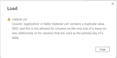

I have tried to un-pivot the material type field in power query to get the below, howev er i then cannot link the databases via application

    If you you unpivotted the table then you are on the right track. Why aren't you able to create a relationship? Still you can match even without a relationship bu the relationship would be much easier and faster. Still not clear what exactly are you trying to match and which value are you trying to grap from which table to which table. Cannot fund the Material Type column anywhere in the provided screenshots. Also what exactly is the Tub Factor? Is it the value that you are trying to calculate?

      Below is the error I get if I unpivot
