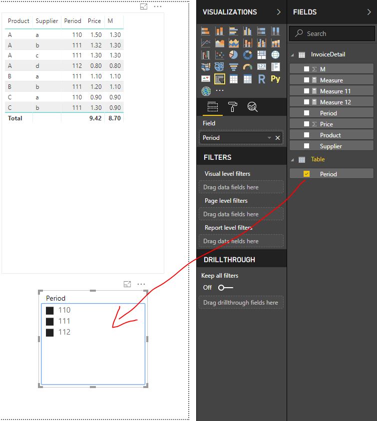

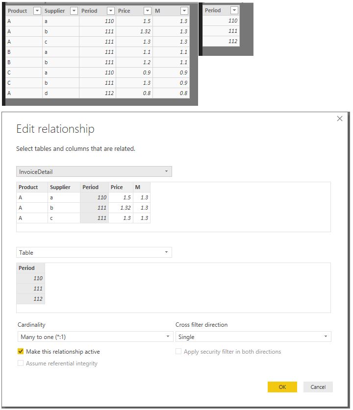

Step1:
Create a fact table for the field you would be dragged into slicer
In my sample pbix, I would use Period
then create a relationship between them
Step2:

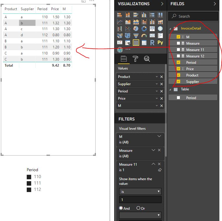

You could try to use SELECTEDVALUE or ISFILTERED to create some simple measure like below:
Measure 11 = IF(ISFILTERED(InvoiceDetail[Period])=TRUE(),1,2) Measure 12 = IF(ISBLANK(SELECTEDVALUE(InvoiceDetail[Period]))=TRUE(),2,1)
Then drag measure into visual level filter
eg. I drag Measure 11 into visual level filter and set filter is 1

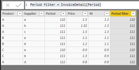

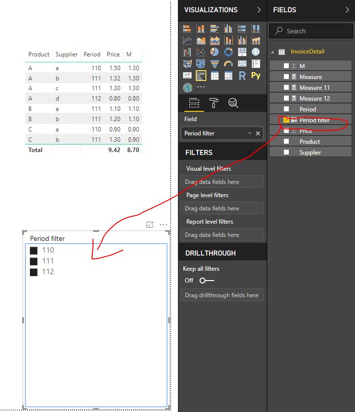

Also, you could copy a Period column
and use these two visual
Measure 11 = IF(ISFILTERED(InvoiceDetail[Period filter]),1)
Measure 12 = IF(ISBLANK(SELECTEDVALUE('InvoiceDetail'[Period filter]))=FALSE(),1)then drag the copy field into slicer
