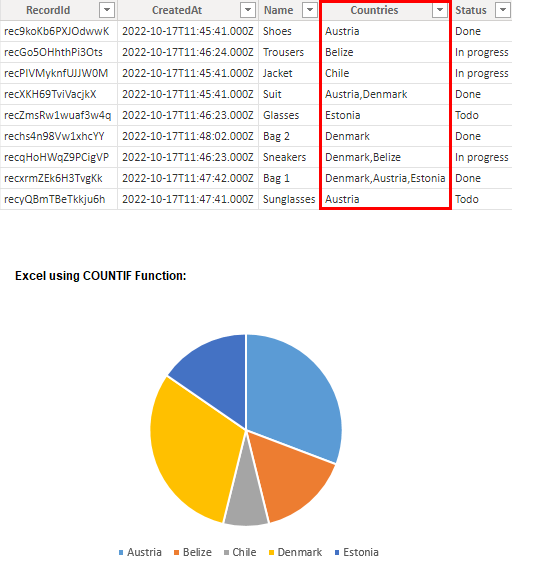

I have data coming in via API which has a List field included (let's say we have 5 options A - E), which can be transformed (values extracted) and I can choose the separator for the concatenation. Obviously, I end up with different combinations and what I'd like to do is get a diagram, which shows me the occurence of A, B, C, D and E, independently. Counting the appearance three cases of B,C as three cases for B and three cases for C instead of creating a new subgroup for this (as it is currently looking):

    Let me try to explain with this example. The column Countries may have several Countries referring to a specific Item. The countries are separated by commas (but that can be changed). I want to visualize the distribution of countries (%) in a pie chart. In Excel, I would for example use the COUNTIF(B2:B10;"*Austria*") function, to get a result of 4 (marked in green). Same then for all other countries (Denmark 4, Belize 2, Chile 1, Estonia 2) and then I can easily create a pie chart from the resulting numbers:
    Simply speaking, I need a way to adopt the COUNTIF function in PowerBI or find an equal way to .

      Hi FaH
      One option is to use Power Query Editor to split Countries column by delimiter comma into rows. Then create a pie chart based on the transformed table.
      Another option is to prepare a Country table which has all distinct country values in advance. Then add a new column in it with below DAX.
      Number = COUNTROWS(FILTER('Table (2)',SEARCH('Country'[Country],'Table (2)'[Countries],1,0)>0))
      I have attached a sample pbix with both demos at bottom.
