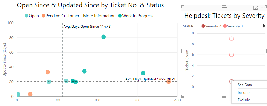

      I am sharing two images and you can see below the include/exclude options do not show up on the left hand side scatter plot that has granular data (that is, I cannot filter out individual tickets), while it does allow me to exclude a ticket category (in this case Severity 2) on the 2nd scatter plot (does not have granular data and was originally a column chart). Is there some other reason that I could be in play?
