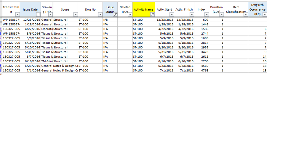

I am trying to get a "ranking" based on the order of appearance of select values in a table, as determined by certain other criteria within that table (Ref. to "Dwg Nth Occurrence (IFC)" column (far right) below.)  More to the point, I want the calculated column to return a rank for each row "Activity Name" value (really a drawing number) if those values also correspond to Issue Status of "IFC".  So, in the example below, we are looking at drawing "ST-100" which was issued a number of times throughout the project, and 21 times specifically as an "IFC" version (9 other times under a different classification).  Each issuance was at a point in time, and the desire is to rank these as based on the "Issue Date" values.

Where I run into trouble is in those instances where the same drawing ("Activity Name") was issued on the same day.  You can see this in the calc. column expression return (ref excerpt above).  I've tried adding another argument referencing the "Index" column (contains unique numerical values) along the lines of "&& EARLIER('Dwg Log'[Index])='Dwg Log'[Index]" to distinguish between those same-date instances but no luck thus far.

      Looks like there is an issue with the second filter argument in that it will not allow for the EARLIER() portion to be executed as written (underscores it in red)
      The error message given is "A function 'FILTER' has been used in a True/False expression that is used as a table filter expression.  This is not allowed"
      It WILL allow for the following (not modification to the 2nd FILTER argument):
      Dwg Nth Occurrence (IFC) =
      CALCULATE([cntR-Jedson Dwg Log],
      FILTER('Jedson Dwg Log','Jedson Dwg Log'[Issue Status]="IFC"),
      FILTER(ALL('Jedson Dwg Log'[Activity Name]),'Jedson Dwg Log'[Activity Name]=EARLIER('Jedson Dwg Log'[Activity Name])),
      FILTER(ALL('Jedson Dwg Log'),EARLIER('Jedson Dwg Log'[Issue Date])>'Jedson Dwg Log'[Issue Date]))
      That yields the following result (still short of goal):
      It also returns values relative to other (non-IFC) classifications, as follows:
