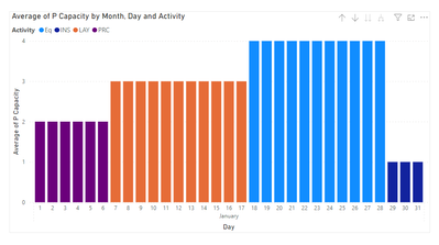

Considering I have a database with a column "Actual date" (X axis) to be plotted with my "P Capacity" (Y Axis) and another column "Actitivty" (Legend), it is easy and straightforward to select a Stacked Column Chart.
Now I need to introduce a functionality where the user can select by how many days they want to shift the "Actual date" by using a slider and this should be added to the "Actual Dates" and then plotted.
Ex: Assuming the user selects 15 on the slider, the new values will be plotted from the 16th of January:

  • Hi Anton93 ,
    Firstly we can't create a dynamic column, in other words, we can't use a dynamic measure in a calculated column.
    According to your description "Assuming the user selects 15 on the slider, the new values will be plotted from the 16th of January", if you mean the visual will be filtered to 16 to 31, here's my solution.
    Create a measure:
    Measure =
    IF ( MAX ( 'Table'[Actual date] ) > 'Parameter'[Parameter Value], 1, 0 )
    Put the measure in visual filter and select show items when the value is 1.
    After apply filter, get the result:
