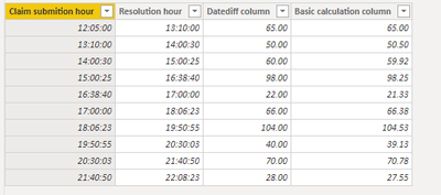

  • Hi magus ,
    Basically the datediff() function should work when the date format is HH:MM:SS.
    You can also create a calculated column like this to calculated the minutes diff:
    Basic calculation column =
    VAR diff = [Resolution hour] - [Claim submition hour]
        HOUR ( diff ) * 60
            + MINUTE ( diff )
            + SECOND ( diff ) / 60
    Attached a sample file in the below, hopes it could help.

      Hello! I would like to get a new column with waiting time in minutes (difference between Hour of claim submition - hour of resolution). Like this:
      The example that I show is a result I got in other Query, but in that query I had Source Data with DateTime format. The formula was like below:
      Waiting Time = DATEDIFF('Source Data'[Claim submition hour], 'Source Data'[Resolution hour], MINUTE)
