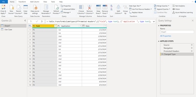

Hello. I need to calculate the difference between the dates of different applications:
Field Application  Date
P1  1st01/01/2024
P2  1st01/05/2024
P1  2nd01/20/2024
P2  2nd01/22/2024
P1  3rd02/10/2024
P2  3rd02/11/2024
P1  1st02/15/2024
P2  1st02/15/2024
P1  2nd02/27/2024
P2  2nd02/28/2024
P1  3rd03/10/2024
P2  3rd03/11/2024
P1  1st03/14/2024
P2  1st03/16/2024
P1  2nd03/20/2024
P2  2nd03/24/2024
P1  3rd04/02/2024
P2
  3rd
04/05/2024
For example, I need to take the dates of the 2nd application of P1, select the oldest of them, and subtract the oldest date of the 1st application of P1. Therefore, I need to take the dates of the 3rd application of P1, select the oldest of them, and subtract by the oldest date of the 2nd application of P1. In the truth table, there will be more types of application, such as 4th and 5th. And so on with all Fields.

  • vigneshba's avatar
    vigneshba
    Hi jobf - I hope you are expecting below result
    Please follow below steps to achieve this.
    I have just loaded the same dataset in Power BI and created a reference in Power Query and grouped this table with Field and Application to get Oldest Date in Power BI. I have created reference here not to disturb the Original Data but we can apply group by directly on the Original Data
    You have to create 1 Calculated Measurement which I have created as Prior Oldest Date here to get the prior date for every group (Field and Application) and first item it will be blank as there are no prior dates available
    Prior Oldest Date = CALCULATE(MAX('Use Case'[Oldest Date]), FILTER(ALLEXCEPT('Use Case', 'Use Case'[Field]), 'Use Case'[Oldest Date]<EARLIER('Use Case'[Oldest Date])))
    You have to create one more Calculated Dimension to find the Date Difference between these 2 dates now
    Date Difference = DATEDIFF('Use Case'[Prior Oldest Date], 'Use Case'[Oldest Date], DAY)
    Hope this helps you to do date difference between the dates in the same column
