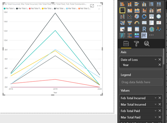

I am new to Power BI and am struggling with finding a solution to a data visualization questiion. I currently using a line chart that displays four different reports (monthly calculated sums) by year with two months worth of data listed(displaying 8 different calculated sums by month: Total Incurred, Total Paid, Total Outstanding Reserves, Total Third Party Recovery) I used a date of loss(year) for the axis and the caluculated sums for the values within the chart. As this grows, it will be difficult to view. is there a way that I can group the data by report in order for a user to select which report(s) to view?

I appreciate your help in this. I'm sorry, let me try to explain myself better. I have a table that contains the following data:
I am able to create the line chart that plots the report totals for each month over the three years using the loss date for the axis and the sums of each report for the values, but it is not easy to read:
My client wants to see the chart above, but also has the ability to select a report to view. For example, Total February Paid for Years 2018, 2019, 2020 against Total March Paid for Years 2018, 2019, 2020 . I'm having trouble figuring out how to cut the chart in a way that would allow my client to select from a list of reports.

I appreciate your help on this. I am sorry, let me try to explain myself better. I have a table which contains the following data:
I am able to create the line graph that charts each month's report totals over the three years by using the date of loss for the axis and the sums of each report for the values but it is not easy to read:
My customer wants to see the above graph but also have the ability to select one report to view. For instance, February Total Paid for Years 2018, 2019, 2020 against March Total Paid for Years 2018, 2019, 2020 . I am having trouble figuring out how to slice the graph in a way that would allow my customer to select from a list of reports.
