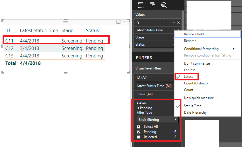

Hi KiranPatil,
You can filter the Status and choose the latest Status Time. Please refer to the snapshot below.
Dale
