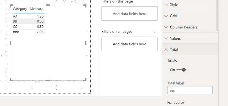

v-deddai1-msft
Hello @vinaydavid ,
Please try the following measurement:
Measure =
IF (
    HASONEVALUE ( 'Table'[Category] ),
        DIVIDE ( COUNTROWS ( 'Table' ), AVERAGE ( 'Table'[Capacity] ) ),
        ALLEXCEPT ( 'Table', 'Table'[Category] )
    SUMX (
        SUMMARIZE (
            'Table',
            'Table'[Category],
            "_a", CALCULATE (
        [_a]
If this post helps, then consider Accepting it as the solution to help other members find it more quickly.
