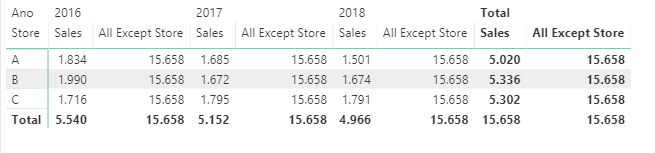

I want to calculate the sales for all the years for each store:
All Except Store = SUMX(ALLEXCEPT(Table1;Table1[Store]);Table1[Sales])
This is returning the following:
enter image description here
It's nonsense! It's removing ALL the filters, so to calculate the sales for all the years and KEEP the filters on the store using ALLEXCEPT I can use:
All Except Store2 = CALCULATE(SUM(Table1[Sales]); ALLEXCEPT(Table1;Table1[Store]))
This one works.
But why doesn't it work with SUMX?

AllExcept behaves differently when used as a set filter in Calculate or when used to return a table. In the former case, all filters removed except for the filters on the specified columns.
SUMX(ALLEXCEPT(Table1;Table1[Store]);Table1[Sales]) means return a table of all rows in Table1. The returned table has all columns in Table1 except the [Store] column. Afterwards, calculate the sum by iterating over the returned table.

All Except Store = SUMX(ALLEXCEPT(Table1;Table1[Store]); CALCULATE(SUM(Table1[Sales])))
Yep, that one works too. CALCULATE has magical powers!

You are using the ALLEXCEPT in an unusual manner.
Create a new table to see what the result of ALLEXCEPT(Table1;Table1[Store]) is. I think that will clarify what is going on.
