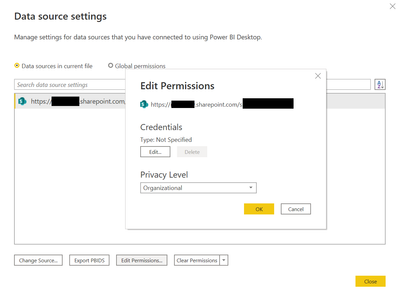

        I just revisited this case to try and clear the permissions in the data source setting, nothing seems to happen:
