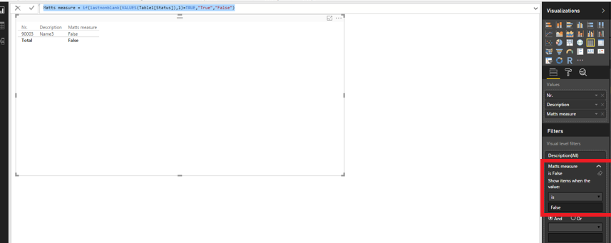

Hi @skype_see4d,
What result do you want to get after you select False value in a slicer? If you what to return all Nr. that have FALSE status, then just create a slicer using Status field, then use it to filter your visual.
If you want to return only 90003 that has FALSE status after selecting False value, use the following formula to create the Matts measure, then use Visual Level filter instead of slicer to filter your visual as shown in the following screenshot.
Matts measure = if(lastnonblank(VALUES(Table1[Status]),1)=TRUE,"True","False")
Thanks,
Lydia Zhang
