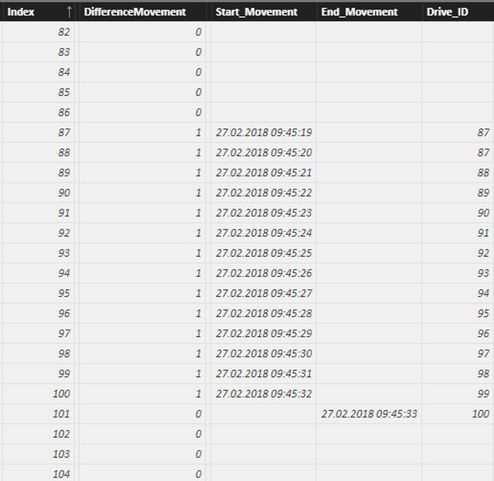

Localizing moving objects I'm using an inertial sensor on an Arduino board. Every time I notice movement I have created a flag value 1. Now I'm trying to get the Start and End Date of this movement and combine them to one "Drive". Calculating the start end value isn't the problem, but to create a row to identify them as one movement.
Currently my table is looking like this:
Since the value of this "Drive_ID" doesn't matter I was using the Index value for the first not blank value in the Start_movement column.
Now I try to Copy the value for Drive_ID from the row above as long Start-movement or End_movement isn't blank but somehow I'm not able to.
Any ideas of an easy solution? Is there any different way of how to get this information. The idea is to use a Gantt chart later to display

    • fishboneox's avatar
      fishboneox
      The Start and End Date is collected from a different column containing a key of date and time.
      To be able to use the data later for the Gantt chart I need a different start and end column linked by an ID (here Drive_ID).
      I'm not sure if I understand your answer. Here you can find some sample data:

      • MattAllington's avatar
        MattAllington
        I'm happy to have a go at it.  But I'm not clear what your starting position is.  You have provided an image with seemingly a before and after image, and also some sample data.  The "before" image and the sample data are different.  If you can provide some exact sample data, preferably with at least 3 complete events I will take a look (ideally in a table in Excel (Maybe linked via Dropbox or similar)
