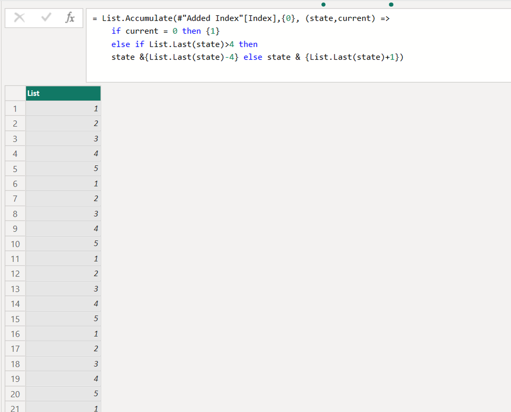

Hi @k_rojvanakarn , @ryan_mayu , @Anonymous
Might be useful for you.
In this case, I generate values from 1 to 5 and repeting them based on Index column.
= List.Accumulate(#"Added Index"[Index],{0}, (state,current) =>
    if current = 0 then {1}
    else if List.Last(state)>4 then
    state &{List.Last(state)-4} else state & {List.Last(state)+1})
Here is a good video related how to use other approach https://youtu.be/Hc3d8rMSXcQ?si=S1Adls_HbrgPn4bw
