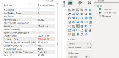

Hello all - I have a business request to conditionally format 2 date lines in a table and highlight the values red if we're within 90 days of the date. I tried with ChatGPT, but it couldn't get me there unfortunately. So I need actual human help 🙂

What I need is the DAX query, in addition to the current formatting being applied, is check if the value for Expiration Date or Effective Date is within 90 days, and if it is, then highlight the font in red, for example.
Hi @peterg0417
Thanks for your explaination, please try this:
First of all, I add a measure:
Measure =
	VAR _DateofAttribute = SELECTEDVALUE('Table'[Attribute]) = "Effective Date" || SELECTEDVALUE('Table'[Attribute]) = "Expiration Date"
	VAR _DateDiff = IF(
		_DateofAttribute,
		ABS(DATEDIFF(
				DATEVALUE(SELECTEDVALUE('Table'[Formatted Value])),
				TODAY(),
				DAY
		IF(
			_DateDiff <> BLANK() && _DateDiff < 90,
			"Red"
Then click the [Formatted Value] field and choose the Conditional formatting > Font color
Choose Field value and select the measure in the what field should we base this on? multi-check box.
The result is as follow:

Thank you for your help, but not sure this accomplishes what I need.
I need only the rows with the 2 dates (Effective Date and Expiration Date) to be red if they are less than 90 days away. Whereas this formatting changes the entire column to red, and I can only set the rules on 1 field (Days Until Effective OR Days Until Expiration)

Please see "Expiration Date". The date is highlighted in red because it is within 90 days. I want to apply this conditional format within the existing DAX measure, "Formatted Value" that I provided above. For Expiration Date and Effective Date.
The issue is that  The values are all text, unless it's a number. If it's a number then I apply a custom format string to it, from the variable "_Formatting"
Hi @peterg0417
Measure =
	VAR _DateDiff = IF(
		_DateofAttribute,
		ABS(DATEDIFF(
				TODAY(),
				DAY
		IF(
			"Red"
