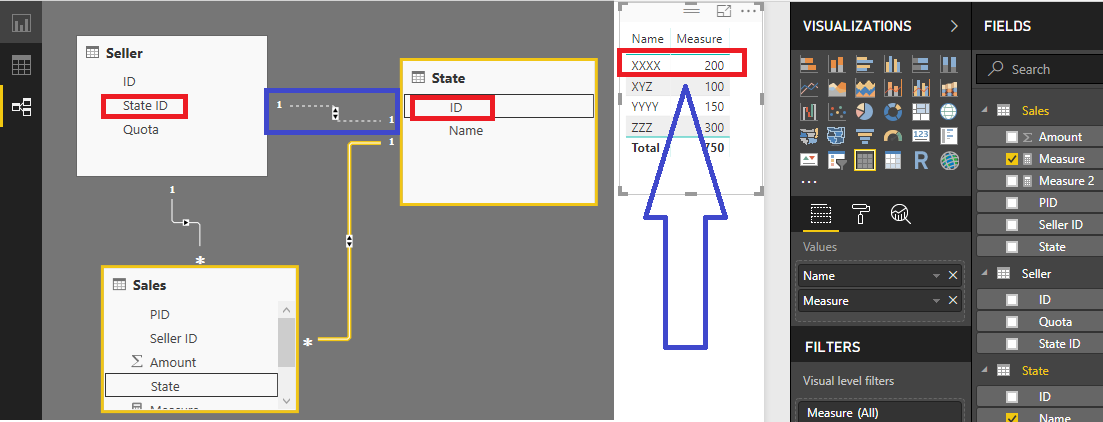

Lets consider i have a model like this. Relationship between sales and state is both
I want to see quota by state in a table
Quota of state XXXX will not be displayed in table as it has no sales table records, Is there any way to get that record without modifiying this model ?
I know we can achieve this by changin the model as below
But this model is reducig the performance when Seller details and sales data are seen together (We are doing this in direct query)
May be this could be a simple fix, Any help is appreciated.
Thanks,
Dinesh J.
  • Hi Dinesh,
    There could be two methods.
    Method one:
    1. Create a new inactive relationship;
    2. Create a measure.
    Measure =
        SUM ( Seller[Quota] ),
        USERELATIONSHIP ( Seller[State ID], State[ID] )
    Clarification_in_table_relationship1

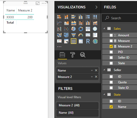

    Method two:
    Create a measure.
    Measure 2 =
    IF (
        MIN ( State[ID] ) IN VALUES ( Sales[State] ),
        BLANK (),
            FILTER ( Seller, Seller[State ID] = MIN ( State[ID] ) )
    Clarification_in_table_relationship2

      Hi Dale,
      This solution worked.
      Thanks,
      Dinesh J.
