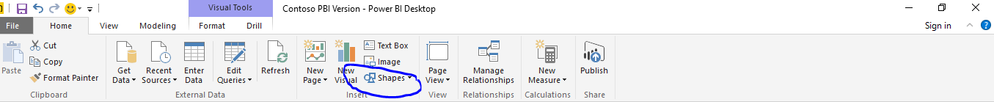

You can create Horizontal reference line but not Vertical line. To do that, You need to use one trick.
Use Shapes as shown in the screenshot but it is not dynamic and changing the size of the visual will change the position as well.vertical line.PNG
I think you should post this requirement under the new ideas to get that in near future.
