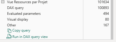

I have a issue to charge my table, it´s taking a long time, the issue on performance analyser is the dax query, I have only this parameter applied to change the two diff, types of charge.
Is there a diff way to create a new mesure or parameter to improve the speed?

It looks like your table visual is taking too long to load because the DAX query is doing too much work behind the scenes, especially with that parameter and your calculated columns. Don’t worry, here’s a clean and easy way to fix it and speed things up.
Move the calculated columns to Power Query. Those two columns you created using DAX like “Nom du Projet” and “Nom de la Ressource”  they’re better off created in Power Query, not DAX. Why?
Because Power Query does this once when data loads DAX has to carry them around every time you view the report.
In Power Query, For Nom du Projet.
if [Code projet] & " - " & [Libellé projet] = "- - -"
then "- Disponibilité Totale"
else [Code projet] & " - " & [Libellé projet]
For Nom de la Ressource:
[Nom ressource] & " - " & [Prénom ressource] & " (" & Text.From([UID ressource]) & ")"
You’ll find this in Transform Data -- Add Column -- Custom Column.
Now Replace your parameter logic with a simple slicer
That Paramètre = { ... } logic is making Power BI work too hard. Instead, let’s create a small helper table and use a cleaner measure.
Create a new table (no need to link it) and use bellow measure.
Charge Options = DATATABLE("Charge Type", STRING,{{"Charge unite"},{"Charge AED Unite"}})
Now create one measure that changes automatically based on what you select.
Selected Charge = SWITCH(SELECTEDVALUE('Charge Options'[Charge Type]),"Charge unite", SUM('FAIT_INDICATEURS'[Charge unite]),"Charge AED Unite", SUM('FAIT_INDICATEURS'[Charge AED Unite]))
