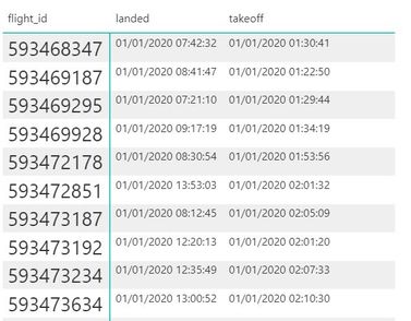

Dear MS PBI Experts I am hoping someone can help me out here... I think this problem is relatively simply but I only started using PBI today... I have tidied up my data and presented it as a Matrix, where each row represents a flight and each column is take-off and land. In Excel I can subtract one number by the other to get the duration of the journey... but how do I do this on PBI Matrix Visulisation... any idea? Thank you all!

Thank you so much for your help everyone! ... but I struggled to get it to work.
A little background on the raw data, every single flight_id corresponds to two seperate row: one for take off and one for landing - see snapshot below:
(Stamp field just combine date and time field.)
So first I pulled the data into a Matrix visulisation to get it in the format below so I can see the correspnoding landing and take off time for each fligth_id. But now I'm strugglign to find the duration as the SUMX function doesn't recognise takeoff and landing as a variable in the tabe...
Thank you everyone once again for your help!
