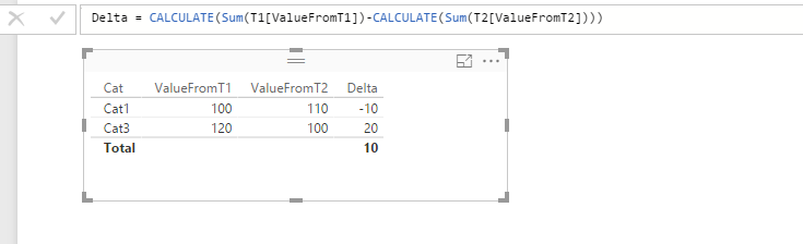

I have 2 queries from two datasources. I can merge these 2 queries and display the result like this
Cat, Value from T1 Value from T2
Cat1     100          110
Cat 2    100          100
Cat 3    120          100
I want to add column Delta which should be Value fromT2 - Value from T1
Then filter on that to retain Delta <> 0
Seems simple but I cannot get it to work.

Table Structure and RelationshipTable Structure and RelationshipCreate a measure "Delta"Create a measure "Delta""This is table Values and Visual Filter"This is table Values and Visual Filter

thanks Victor, this works fine and get me started.
