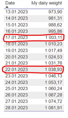

Calculate difference between moving average value of two different dates
I have daily observations with a bit of variability in their measurements, so I'm calculating a 30 day moving average.
I do so with the following DAX and it works fine:
My daily weight moving average =
Smartavgmoving =
VAR _Maxdate = MAX( 'Date table'[Date])
RETURN  CALCULATE( AVERAGE( Table[My daily weight]), DATESBETWEEN( 'Date table'[Date], _Maxdate - 15, _Maxdate +15))
As expected the output looks like this:
I want to calculate the rate of change between certain periods (for example, between every first and last of a month) but no matter how I try to pass a date filter to my moving average calculation, the outcome is always the table above.
For example, the measure below results in the same table as posted above.
=CALCULATE( Smartavgmoving, Table[DATE] = dt"2023-01-17"))
Can somebody point me in the right direction?

    • Mr_Glister's avatar
      Mr_Glister
      Icon for Advocate II rankAdvocate II
      Hi amitchandak,
      (Nice to get help from one of the forum heroes!)
      I will try your suggestion and I'm sure it will work for this narrow case. But the real reason I posted this to the forum is the following question:
      Since my original measure correctly calculates a value for each date, shouldn't I be able to directly access the values of each date? For example, if - for some reason - I wanted to calculate the difference of exactly the two dates I highlighted. Or put differently, why does the DAX below not work and how would I have to do it correctly?
