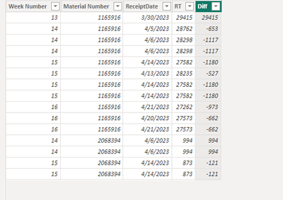

Thanks for the help, i try the formula and it works but it works on the grouped table for all the week.
How about if i have this table like this
i try to use your formula but it seems the difference it's not same as it have multiple weeks in the same material number and i have many different material number.
My expectation is it can show the difference for each of material number from previous week but specifically at the last date of that particular week (Date is from Receipt Date column)
In the result i could know if there is significant qty drop from each week, which material number that contribute the most to the reduction.
Need your help for this.

Hi  @MuhamadIlhamsya
You can refer to the following calculated column
Diff = var a=MAXX(FILTER('Supply_Chain Inventory_Forecast',[Week Number]=EARLIER('Supply_Chain Inventory_Forecast'[Week Number])-1&&[Material Number]=EARLIER('Supply_Chain Inventory_Forecast'[Material Number])),[RT])
return IF(a<>BLANK(),[RT]-a)
Best Regards!
Yolo Zhu
