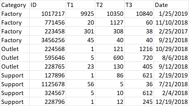

I have a table with the below data. Here T1,T2,T3 are in minutes and date column also available.
enter image description here

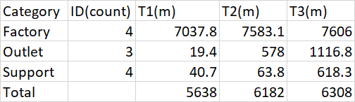

Based on this table data, I wanted my output to look like this

For Category Factory, I wanted to calculate the 90th percentile for T1(m) from TableA data with the fomula like = percentile.Inc([9925,20,301,45],0.90) which gives me the ouput value equals 7037.8 and for Total in the ouput also would like to calculate the 90th percentile for T1(m) equals 5638 using the same formula.

Hi @LivioLanzo ,
Please find the below tables.
CategoryIDT1T2T3Date
Factory1017217992510350108401/25/2019
Factory7714562011276011/10/2018
Factory223458301308382/25/2017
Factory34562564540409/21/2018
Outlet2245681121121610/29/2018
Outlet59564656907208/6/2018
Outlet228765231304059/12/2018
Support1278961866212/19/2019
Support1125678565367/21/2018
Support3245675106122/4/2018
Support22879611224512/19/2018
My output should be like :-
CategoryID(count)T1(m)T2(m)T3(m)
Factory47037.87583.17606
Outlet319.45781116.8
Support440.763.8618.3
Total 563861826308
