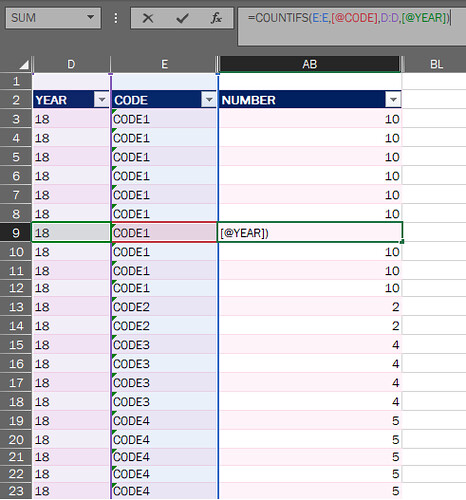

I'm currently trying to move my excel sheets over to Power BI, however I'm having trouble with some COUNTIFS.
My current excel formula is like so:
Power BI Question
I'm currently using this formula in individual columns in Power BI:
NUMBER = CALCULATE(COUNTROWS('Table'),FILTER('Table','Table'[YEAR] = "18" && 'Table'[CODE] = "CODE1"))
But I would like the Number to be calculated all in one column, with the "18" and "CODE1" to be chosen from the individual rows, as I have it in Excel.
Any help is much appreciated

Thanks @Mariusz, that worked!
What if I wanted to use ALLEXCEPT and FILTER ?
i.e. I want to have the individual row filters, and also wanted to have a fixed filter such as "CODE1", etc
Something like so...?
NUMBER = CALCULATE(COUNTROWS( 'Table' ), ALLEXCEPT( 'Table', 'Table'[YEAR] ), FILTER('Table','Table'[CODE] = "CODE1"))
Mike
I think I figured it out by using the FILTER outside of the ALLEXCEPT
NUMBER=CALCULATE(COUNTROWS('Table'),FILTER(ALLEXCEPT('Table','Table'[YEAR]),'Table'[CODE]="CODE1"))
